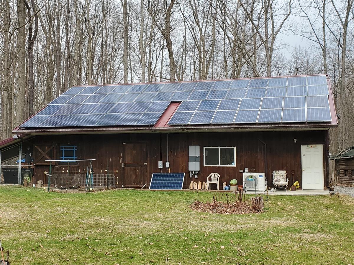

    I add a single panel to my barn array every fall/winter when the sun is low in the sky and the barn roof overhang won't cast a shadow on it. It's a spare panel I bought when I installed one of the upper arrays, and I had a spare microinverter, so I just added it to the circuit with 14 existing roof panels.  Far less than $1000, the panel was around $200 and the microinverter even less than that.  A few odds and ends to make the connection and voila, balcony solar.
    Edit: Tried to attach a photo, no luck.

    Great idea. You are ahead of the times. I'm wondering - since you are using microinverters, why not leave the module up all year? In summer when it is shaded it will still put out a little due to the diffuse light and won't reduce the output of the rest of the modules since they are independently MP tracked? Save you the trouble of removing and installing it.  Also, was the microinverter originally installed and registered with the company so it can communicate power readings, etc (since everything nowadays has to be linked to the mothership). If it is a rogue device, does the network recognize it?

    Steve, I didn't think it would generate that much in the shade but I'll try it next year (leave it installed).  The attached microinverter (Enphase M215) is in their system and is included in reports, etc.  Or as you say, it's linked to the mothership:-)  - Mike
