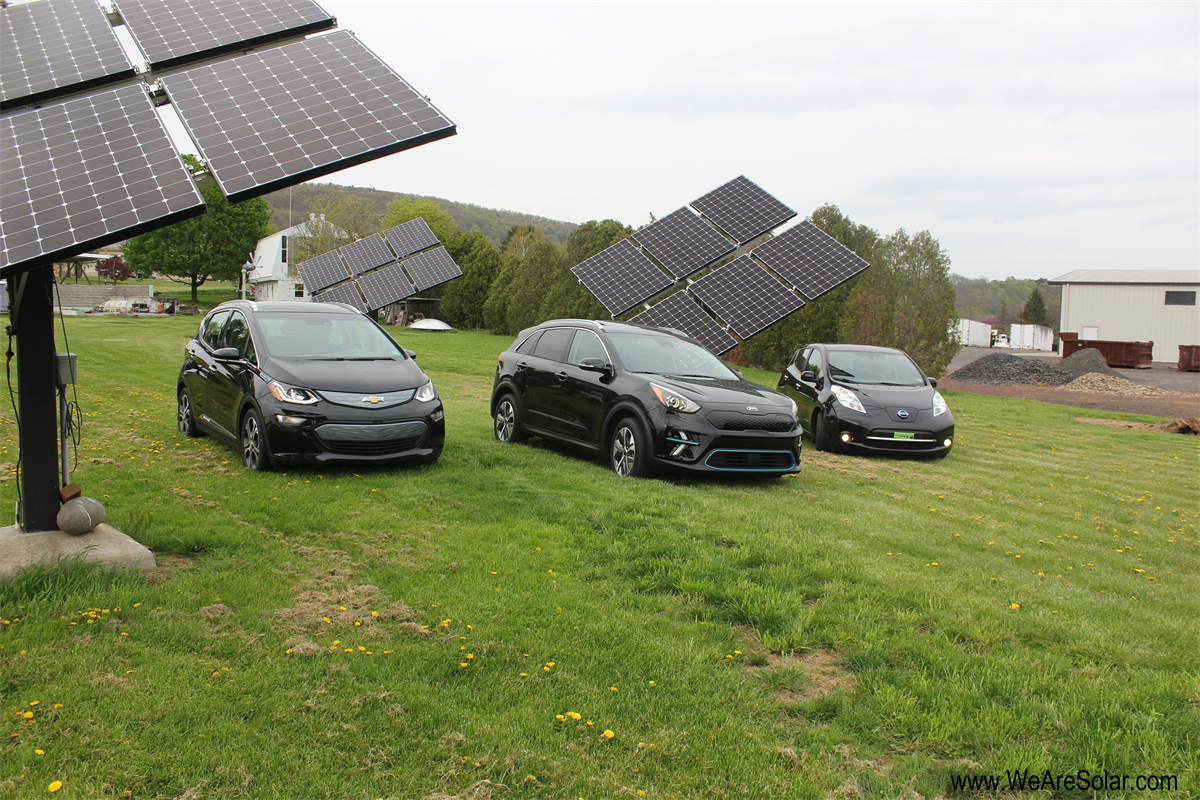

    Hi: Trackers are not simple. I have six single axis trackers that follow the sun with seasonal (Twice) adjustment. Pseudo polar axis tracking, etc..
    The type you are discussing are usually row trackers from East to West. They have really good results from March thru Sept when the sun is higher. Less so in the Fall and Winter. You can track any thing from a single collector thru MW arrays. Its all about the way you want to track. My trackers only have 6 panels on them, about 2KW per tracker.
    2KW trackers

    But to your specific situation, yes you can do East/West tracking. The ideal location is a hill sloping down to the South, then the East/West on that. Evens out production over the year. You only need a 15 or 20 deg slope to help allot...
