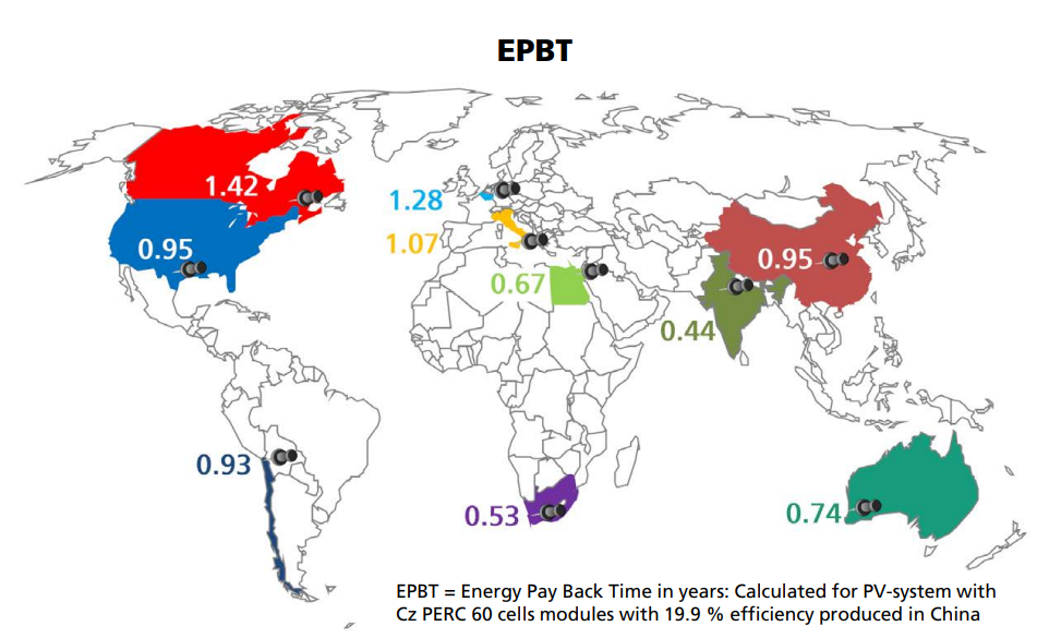

Energy payback time for solar PV systems is dropping as more efficient cell manufacturing processes are developed.
For rooftop PV systems, in 2004 an NREL document stated an energy payback time of less than 4 years for multi-crystalline based systems and 3 years for thin-film based systems. (https://www.nrel.gov/docs/fy04osti/35489.pdf)
A more recent 2022 report by Fraunhofer found roughly 1year energy payback time for mono-crystalline systems. From the report, the number varies from 0.44 years (India) to 1.42 years (Canada) depending on the location as shown on the map. (https://www.ise.fraunhofer.de/content/dam/ise/de/documents/publications/studies/Photovoltaics-Report.pdf)
There are several studies estimating the energy payback for renewable energy systems. If the search is focused on solar cell-level energy payback maybe you will get more results and more accurate numbers. At the system level, it is harder to estimate the energy cost of various components each with a complex supply chain structure.
