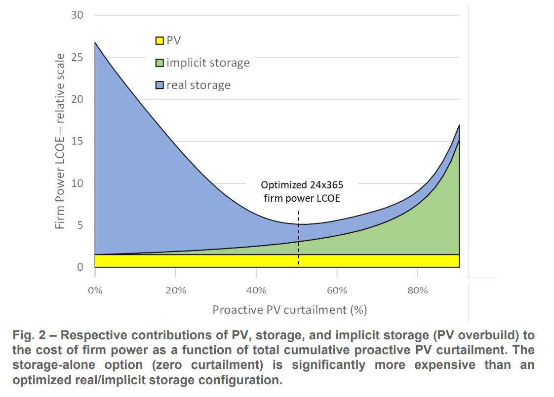

    Concerning the storage size requirement I found an interesting report on this platform about "Firm power generation". The report claims that overbuilding solar PV capacity and curtailing the production on purpose is much cheaper than trying to capture 100% of production with a huge storage.

    I like the graph. Sums it up nicely on the cost end.
