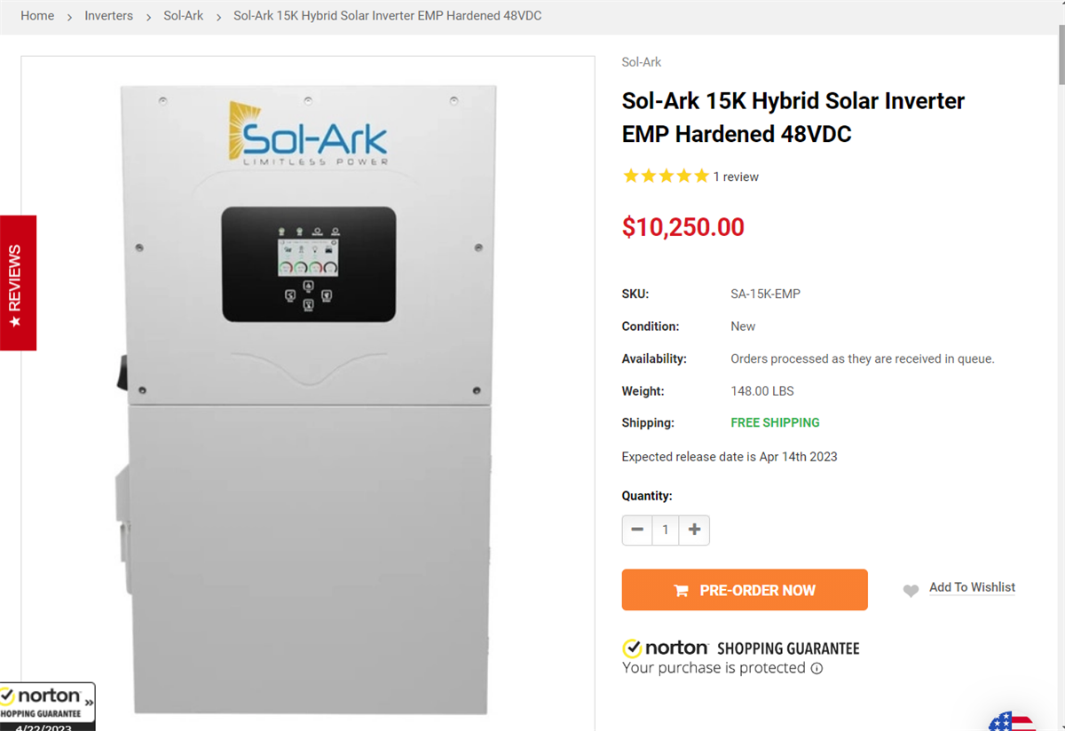

Yes, I have no personal experience with Sol-Ark. But their specs note that the upper DC voltage is 500VDC. All my systems are geared to 600, so wouldn't be a fit for me. The hardest thing with AC coupling of different types of inverters, is that sometimes they do like like to "play nice" with each other when in backup power mode. Additionally, "normal" ac coupling does not give you control over overcharging the battery bank, again when in backup power mode, trying to utilize the output from you "main" grid tie inverter. One unit solves this issue, allowing all the loads and production to be balanced "on the fly".

Just as a small note, you can see some of the technical specs in some of the inverter manufactures advertising their inverter as "EMP hardened" like Sol-Ark 15 kw grid tie inverter. Note the upper right.
