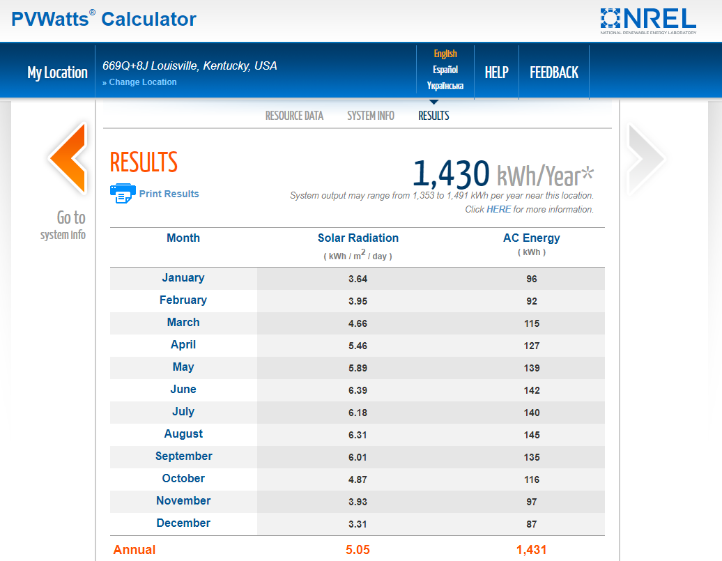

Thank you Prof. Keith for including PVWatts in the list.
This is really a user-friendly tool, .....just write the location address, and in 1-2 clicks, it provides how many kilowatt-hours of energy the default solar PV system will produce monthly. Thanks.

You probably know about PVWatts, also. I wouldn't be surprised if the tools you listed incorporate PVWatts for their calculations. The thing I like about PVWatts is that it is so simple - just pick a location and enter a few inputs.

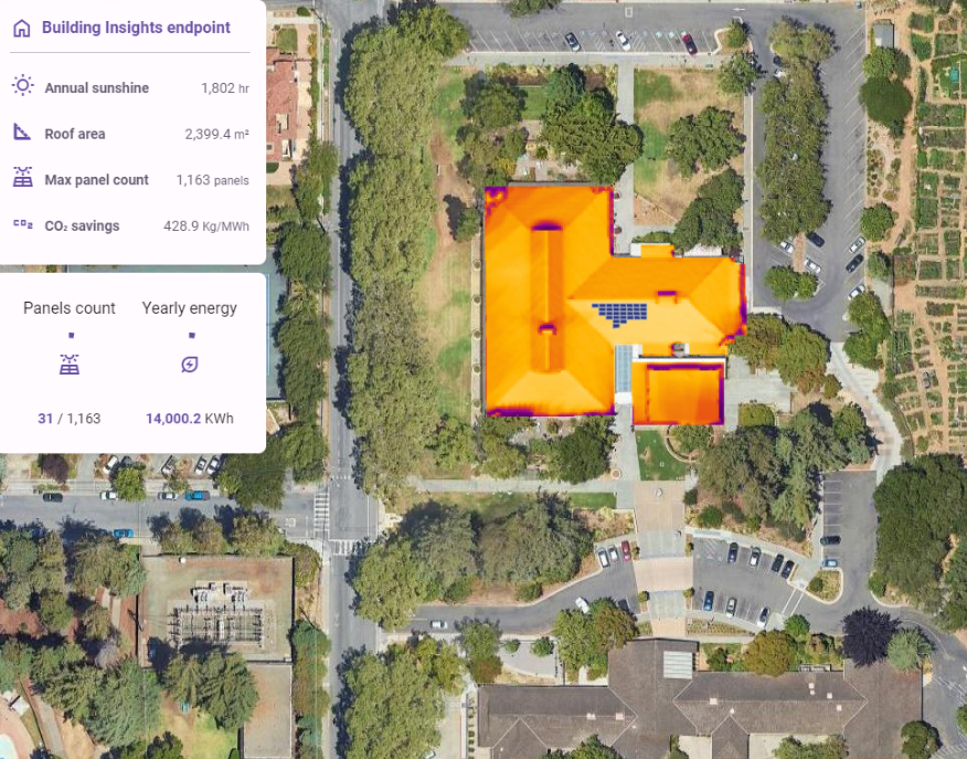

3- Google Solar API 🌐🔍: Ideal for professionals seeking leads by evaluating solar potential at various locations, including rooftops without solar and parking lots.
https://developers.google.com/maps/documentation/solar/overview

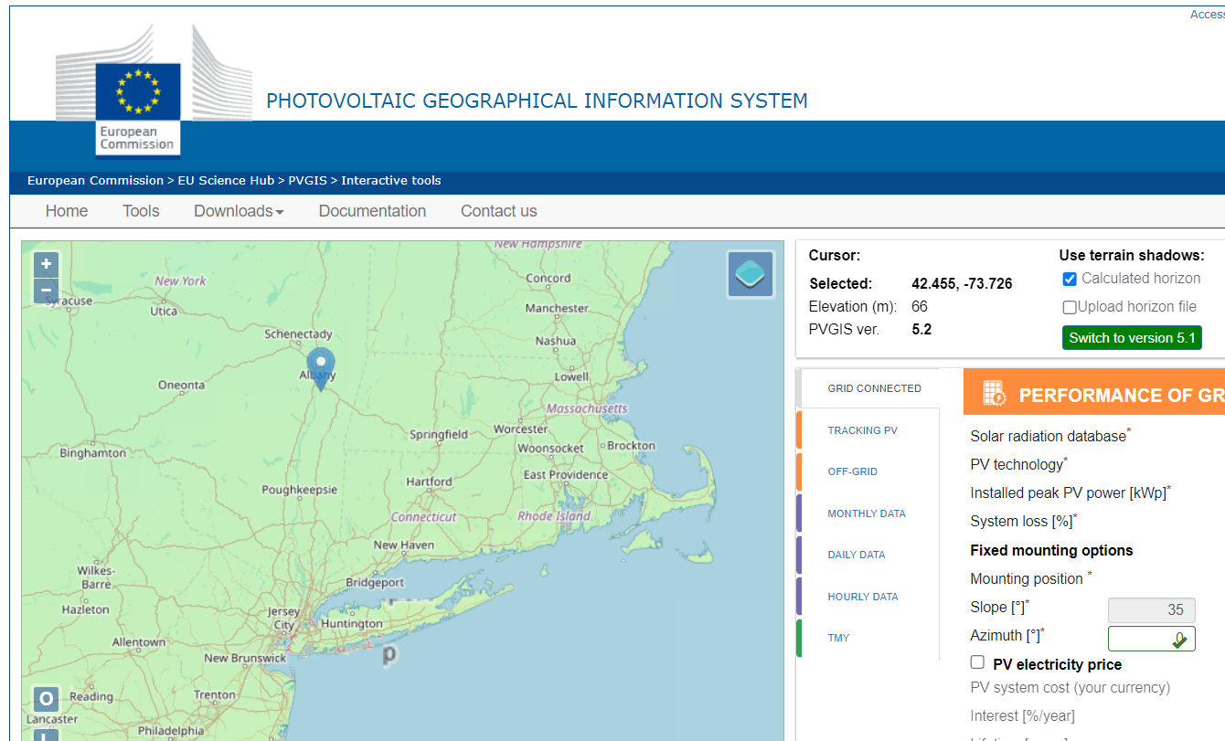

4-PVGIS 🌞🌐: similar to the Global Solar Atlas, it enables the assessment of PV performance at a specific location for various designs (off-grid, on-grid, fixed, tracking).
https://re.jrc.ec.europa.eu/pvg_tools/en/
