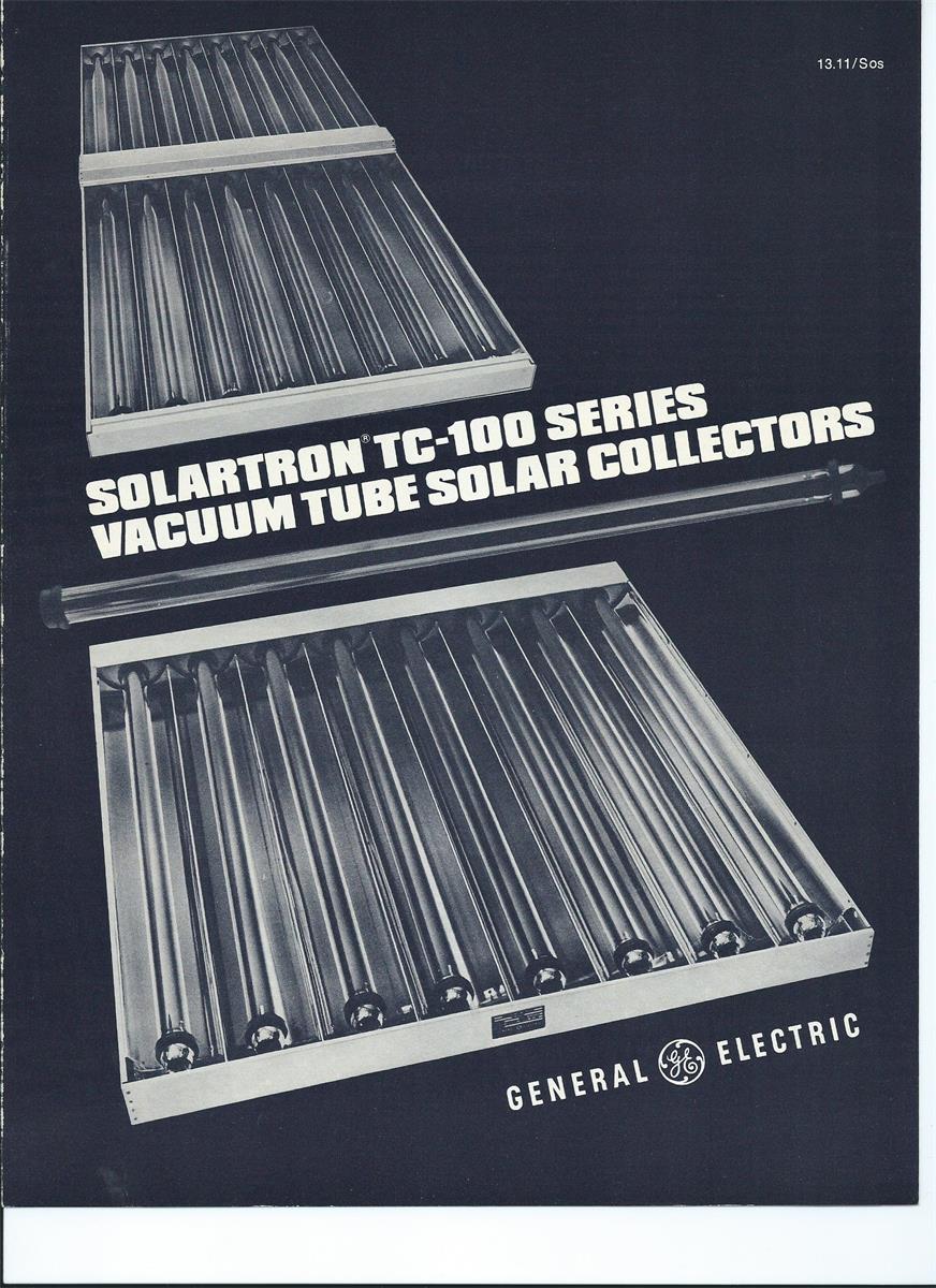

    This is a picture of GE's Solaratron TC-100 evac tube collector with a cusp shape reflector. It debuted back in the 80's..
    First evac collector in the USA
    The easiest way to improve evacs is to just put a foil faced bubble wrap behind them. Any light that "misses" the tubes bounces back on to the back side of the tubes. But if ground mounted, it does increase wind loading if your mounting surface is not solid to begin with....
