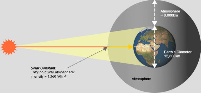

    Solar radiation intensity is approximately 1380 watts per square meter (W/m2) above the Earth's atmosphere, which is known as the Solar Constant. 20 % of 1380 watts is 276 watts being converted  potentially into electricity for use with above average photovoltaic modules on clear sunny days. Average roof size in America is roughly 1700 square feet which equals 158 square meters which means the average home could be totally off the grid with current solar technology utilizing solar electricity without the transmission loss otherwise from solar farms as millions of homes are already doing this worldwide. As this trend continues into the future no other form of electrical generation will be needed for homes other than the light from the sun. ( In ideal conditions, highly efficient futuristic solar panels could produce  up to 1,000 watts per square meter. However, in real-world conditions,  currently they usually only produce 200 to 300 watts per square meter on average. )

    AS noted, the solar constant is ABOVE the atmosphere, so unless you know of some housing in outer space, 20% of STC (1000W) is 200 watts, not 200+ anything.
    "( In ideal conditions, high efficient solar panels can produce around 1,000 watts per square meter. ...."
    Ah, no. This is emphatically wrong. Even the best multi-junction cells in outer space can not achieve those outputs (1000W/sqm), under 1 sun intensity. A 50% efficient multi junction cell (does not exist, yet) in outer space, would only achieve 50% of 1380W = 690W. Here on earth the theoretical max for single junction cells is around 34%. (340W per 1000W at STC).

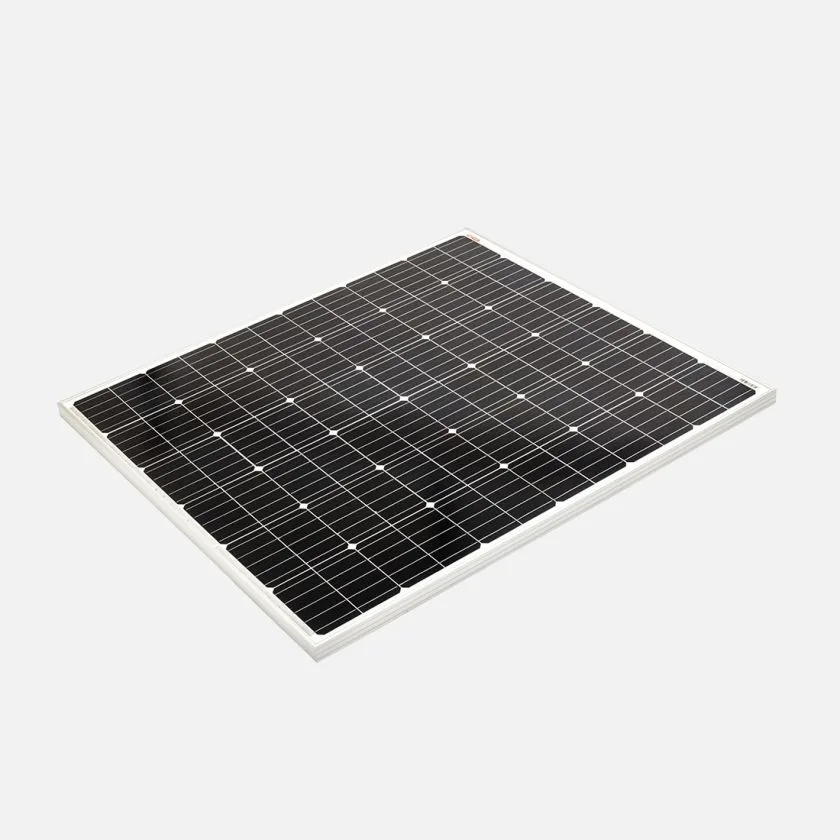

    Bill as an example this PV panel is approximately 1 square meter 43.7" × 39.1" Inches excluding the frames very close.The specs on this panel is 200 watts with an efficiency rating of 20.60 %

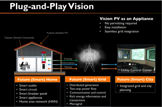

    The objective of this project is to develop, test, and validate a complete Plug and Play PV prototype system.
    https://www.energy.gov/eere/solar/plug-and-play-solar-pv-american-homes
