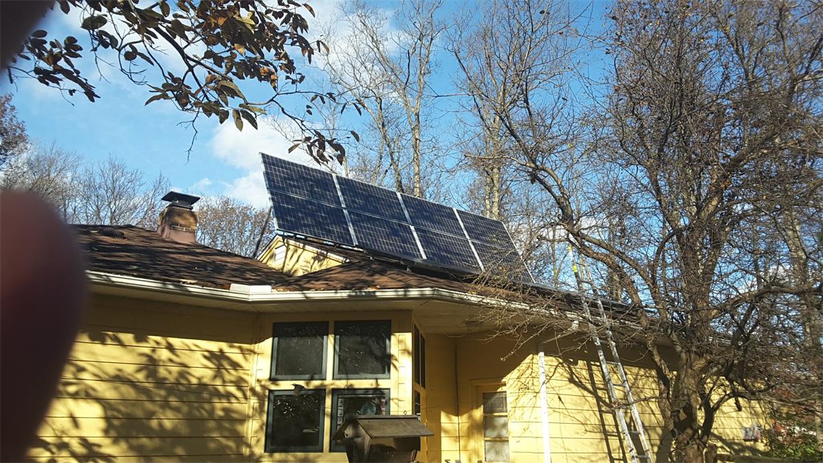

Sent: 09-02-2024 10:13 AM
From: MICHAEL MILLER
Subject: Slar panel mounting
I recently had 39 405 watt q-cell panels installed on my roof with IQ8 inverters. There are 10 panels on the south facing slope of my roof and 29 facing north. The panels facing south have consistently produced twice as much as those on the north slope - primarily I suppose due to the angle sloping away from the sun. I was wondering if there is an easy or recommended way to angle the north facing panels toward the sun without having to spend $50-$100 plus per panel. It seems most adjustable solutions Ive found online are geared towards RV type setups. The company that installed the panels did a great job all around but actively expressed no interest when I asked them about this. Perhaps it would be cheaper to just add more panels, but the difference in production of power between the north and south facing panels does seem quite high to me, as a south facing panel may produce 1.92 kWh in a day while a north facing one only produces 855wh. That is a comparison from yesterday via my Emphase app.
