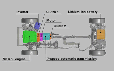

      * Hybrid Cars, and Trucks are needed for cross-country traveling- Hybrids could be hydrogen fuel cells, propane, or gasoline.. etc coupled with integrated PV, advanced lightweight onboard battery storage driving electric drive trains.

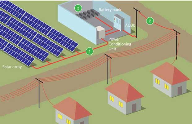

     * Solar Micro-Grids with PV arrays locally can help communities by clustering the electricity including also Bidirectional Charging with EVs.

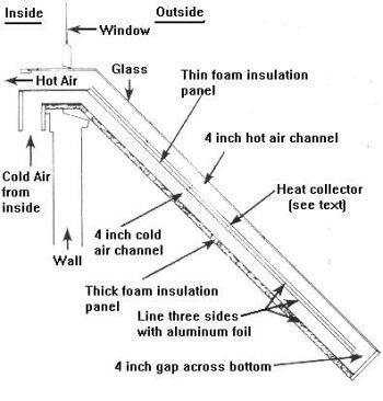

    Passive solar heating systems typically use the south-facing wall, not the roof. Walls are almost always vertical. See the sketch below.
    Back in the day, a number of communities included solar access (for the south wall for passive solar heating, not the roof for PV) in the building codes for new development.
    Passive solar heating is simple. It works without electric power, so it is resilient to power outages and it doesn't need PV or batteries nor an expanded grid as built floor area increases. See my article in the recent issue of Solar Today on six historic and modern homes that are 100% (or nearly so) passive solar heated and passively cooled. Such performance has been possible for over 70 years, but most people don't know about it.

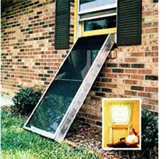

    Yah,  we used to install a unit similar to that was coined a " Heat Grabber "  back in the day.
    The Heat Grabber still has to have a clean line of sight towards the Sun to work efficiently. We are looking at an over built urban sprawl here in America with sub divisions out the wazoo that are attemping to retrofit towards solar with really screwed up orientation solarwise, so most folks are looking for solar PV to do it all electrically like with heat pumps, and other very efficient appliances of course the electronics and lighting is easy with solar, but yes a ground up solar with correct orientation heck yah go for it, passive solar heating with plenty of thermal mass, and mega R insulation correctamundo but still just supplemental towards overall total energy loads as will not be sufficient on those cold dark snowed in wintry days, weeks on end without a backup which is usually a generator or the existing grid.

    No snow or foreign matter build up either. Vertical hot air panels are very effective if within 20 degs. of true South and open exposure.
