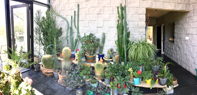

    A room full of large plants adds to the thermal mass. Planters with moist dirt, and large green plants are mostly water. Photosynthesis allows the plants to take in CO2, releasing  O2, and turning the carbon into  protein and beautiful fragrant flowers. I do not know how to compare that to Lithium Batteries.
    Mark Chalom
    Builder/Architect/ Educator
    Solar Design & Analysis
    Santa Fe NM
  • 15.  RE: Thermal mass
    Posted 07-10-2026 01:04 PM
    I don't either. I love plants and have some Cactus that are as big as yours pictured. They are outside now enjoying the Summer heat. Just don't accidentally back into one... OOch!!

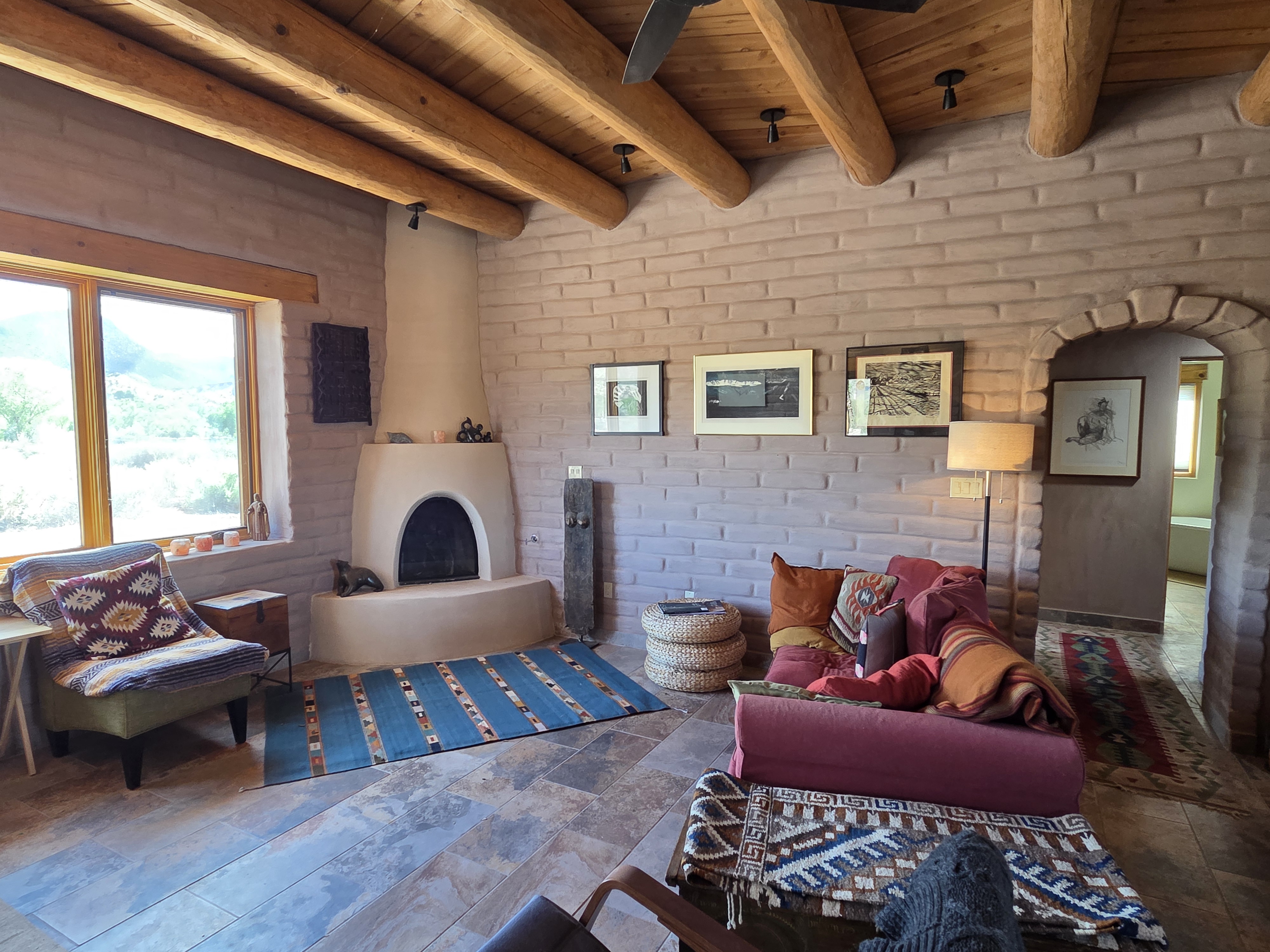

    I love the fireplace! Reminds me of a big chiminea! Great color combination as well...
    Scanned through the article. Evaporative cooling from normal "osmotic" air exchange... nice effect...
    Good that it seasonally swaps... Important data to note...
    In the right climate a good choice...
  • 21.  RE: Thermal mass
    Posted 07-09-2026 06:51 PM
    That's a beautiful Home the southwest adobe is great with the thick walls reminds me of Phoenix. A lot of the old houses there would just use evaporative cooling in the summer (April 1st till November 1st) and it worked great unit Monsoon season (dew point above 55 degrees) then it was a bit of tough sledding. But the old timers there thought it was a badge of honor to not need refrigerant based cooling.
