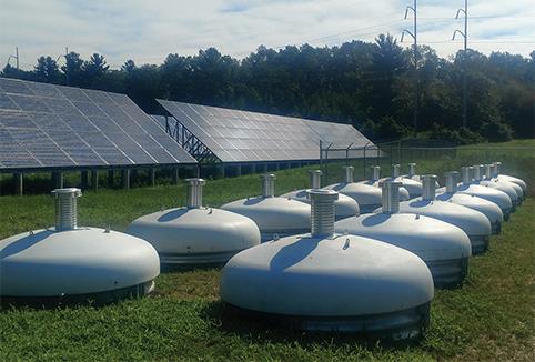

    The flywheels are located next to an existing ground mounted solar array at a distributed energy generation facility. The flywheels were designed for energy arbitrage to reduce peak load and increase grid reliability.
    PV Powered Flywheels
